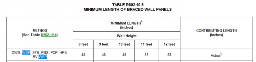

In the 2021 IRC, Section R602.10 details the requirements for wall bracing. Within this section, there's a provision for wall bracing based on a house's seismic design category and braced wall line spacing. Given a home in Seismic Design Category D2 with a braced wall line spacing of more than 25 feet but not exceeding 35 feet, what is the minimum length of bracing required when using Method Wood Structural Panel Sheathing for the braced wall panels?
Couple items...
Take note that the maximum BWL spacing, per Table R602.10.1.3, is actually 25'. An exception will allow BWL spacing of up to 35' in a SFD of one- or two-story construction "...to allow for a single room not to exceed 900 square feet. Spacing of all other braced wall lines shall not exceed 25 feet."

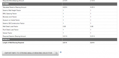

From R602.10.3, "All buildings in Seismic Design Categories D0, D1 and D2 shall use the greater value determined from Table R602.10.3(1) or R602.10.3(3) and the applicable adjustment factors in Table R602.10.3(2) or R602.10.3(4), respectively."
And that's as far as anyone can answer your question, as insufficient information is provided to completely determine values from Table R602.10.3(1) and R602.10.3(3), nor apply the applicable adjustment factors in Table R602.10.3(2) or R602.10.3(4).
One other note to add, in case I misunderstood the question. In the OP, I believe the question is regarding the total length of bracing along a BWL.
However, if the question is simply the minimum width of an individual WSP panel, then the answer is simply 48-inches as per Table R602.10.5.
I'll note further, that partial credit for panels less than 48-inches is unavailable for a WSP panel in SDC D2; see R602.10.5.2.
Then 48"

Again, that is the minimum width of a single WSP unit. The minimum length of the bracing requires calculation from Table R602.10.3(1) or R602.10.3(3), and the applicable adjustment factors in Table R602.10.3(2) or R602.10.3(4).
Yes...but the minimum it could be IS 48"
Not really. Need to have at minimum two panels.

R602.10.2.3 Minimum Number of Braced Wall Panels
Braced wall lines with a length of 16 feet (4877 mm) or less shall have not less than two braced wall panels of any length or one braced wall panel equal to 48 inches (1219 mm) or more. Braced wall lines greater than 16 feet (4877 mm) shall have not less than two braced wall panels.
The end of each braced wall panel closest to the end of the braced wall line shall have an 1,800-pound (8 kN) hold-down device fastened to the stud at the edge of the braced wall panel closest to the corner and to the foundation or framing below as shown in End Condition 5 of Figure R602.10.7.
Wouldn't #2 allow the "center panel" with hold downs and 1 panel?
Varies depending on the height of the wall.
a. Linear interpolation shall be permitted.
b. Use the actual length where it is greater than or equal to the minimum length.
