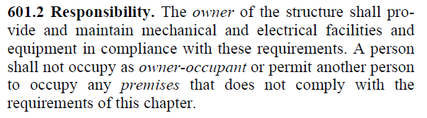

We are under the 2015 International Property Maintenance Code (although 2021 has identical language). Section 102.2 states that "no ... operator or occupant shall cause any service ... or utility that is required under this section to be ... shut off from or discontinued for any occupied dwelling." However, that section does not actually list any required utilities. The occupant (residential) failed to pay his electric bill and the electricity was shut off over a month ago. Is there any requirement in the IPMC that the dwelling's electric service be turned on? If not in the IMPC, then in the IRC, UCC, IBC, NEC, etc.?
From the 2015 IPMC, a little loose, says it must be provided, but does not say anything about energized. Also, what source..... maybe generator?
I lived for five years without electricity. Wood stove for heat and propane lights
My point exactly, when asked to enforce this on owner occupied, I would pull out the generator option, or simply a lifestyle choice...........
The only time I went after it, was a landlord paid utilities, then I would post it, not the tenant's fault.
Down side, the tenant had to vacate

The requirement is for the house to be constructed to the minimum standards of the national electrical code and national building code, which mandate plugs and lights.
Nothing says they have to be energized: just provided.
