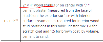

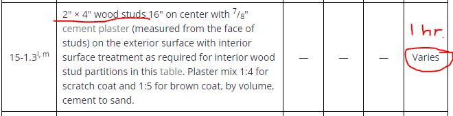

I want to use this assembly, but with 2x6 studs instead of 2x4. I can't find any footnotes or other text in chapter 7 that indicates the stud size is a minimum rather than an absolute.
I know the GA manual states their stud sizes are minimums, but they don't have an equivalent assembly to this.

Another problematic thing with the T721.15-1.3 assembly is that it requires 2"x4" studs, not nominal 2x4 studs.
This can be a dealbreaker for a by-the-books plan checker.
