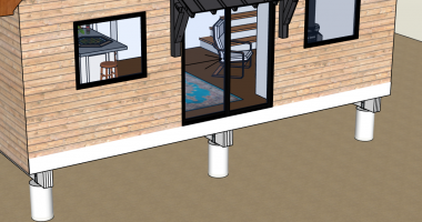

I am working on a deck design and code prohibits attaching deck ledgers to the rim joists of cantilevered floors. The house is a pier and beam with the piers center 12" from edge meaning roughly 10" of the house stick out past the bracket on top of pier.
Is there somewhere that defines a distance at which the house is cantilevered and therefore I cannot use a deck ledger board? I am on IRC 2018

So it's a loose description and I dont consider this house to be cantilevered though I suppose it is if it sticks out a few inches. It can clearly hold the deck. Not sure if this is going to be something I just need to get approved or if there is actually a definition

Okay, in the 2021 IRC that section R507.9.1.2:
R507.9.1.2 Band joist details. Band joists supporting a ledger
shall be a minimum 2-inch-nominal (51 mm), solid-sawn,
spruce-pine-fir or better lumber or a minimum 1-inch (25 mm)
nominal engineered wood rim boards in accordance with
Section R502.1.7. Band joists shall bear fully on the primary
structure capable of supporting all required loads.
I think it means exactly what it says: the band (rim) joist must bear firmly on the primary structure (the foundation).
Why? Because what typically attaches a rim joist to the ends of the floor joists? A couple of nails. The wall above is either 2x4s or 2x6s, so the weight is carried b not only by the band joist but also by the floor joists. But when you attach a deck ledger to the band joist, NONE of that vertical load is transferred to the floor joists, it's all vertical and it puts the nails holding the band joist to the floor joists into sheer -- far more than they were ever designed to carry.
If you need to attach a deck to a cantilevered floor, the code always allows for an engineered solution. That means hiring a structural engineer to design a system that will transfer the vertical loads from the deck ledger back through the cantilever floor structure to the foundation wall.
Time out -- I just took a closer look at your image. You don't have a cantilevered band joist. A band joist rests on a continuous foundation wall. You have three girders that are cantivered out beyond their support piers. I doubt that you have a single 2x band joist -- either the floor joists run perpendicular to the three main carrying girders, or there's a 2- or 3-ply header beam under the wall with the patio door in it.
What you have is either a load-carrying header, or a single- or multi-ply end joist.
Yes you are right. All makes sense now. yes that's a 4 ply beam. I'll go ahead and slap my deck against it. Thanks for clarifying!
