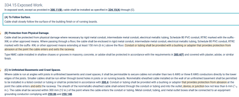

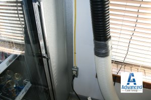

Seems like the issue would be 334.15(B) and whether you consider the installation to be one where it is necessary to protect from physical damage.Yes NEC Article 334.15(A
I don't agree. It is a clear violation of NEC 334.15(B). 334.15 does not say that it only has to meet one of the requirements. Of course, it has to follow the finish, but it must also be protected from physical damage.Yes NEC Article 334.15(A
Welcome to the most subjective part of the NEC.Cable shall be protected from physical damage
The inspector who would agree with that needs to find another career, or they have lost their integrity.The argument could be made that this cable is out of the way and not subject to physical damage
With you, everything is a capital offense.The inspector who would agree with that needs to find another career, or they have lost their integrity.
