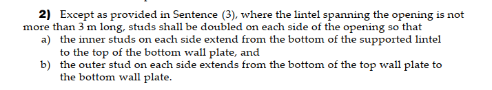

Story: client had intended on a larger door when the opening for his garage was constructed. The door he used is smaller. He used two jacks (only one was required) nailed together but separated from the king stud as shown here:
Question: Under NBC 2015, is this permissible? 'Splain why or why not.
9.23.10.6.(2) requires double studs adjacent to the lintel, one (jack) running from the bottom plate to the underside of the lintel and one (king) running bottom plate to top plate. The double stud provided does not meet this requirement.
If they had KING>JACK>BLOCKING>Jack it would have been fine.
In what practical sense would this not be okay? There is room for a third stud.
One of my lads made the same argument .... but there's no language in the above to state the two have to be adjacent to each other.
Good perspective. And in this case, the span only required one jack and he's got two.
The argument I would make to that would be there is almost always a wall stud adjacent to an opening. If the code does not require that the king is adjacent to the jack, it does not require a king at all, since we could just make an argument that the next wall stud adjacent to the opening serves this purpose as well (nothing says that the second stud must be adjacent to the lintel either).

Not only that -- by spacing the jack studs out (in) from the king, the span of the header is reduced by 1-1/2 inches (or by 3 inches if both sides were framed the same way). IMHO, that makes the structure stronger.
