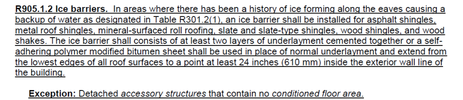

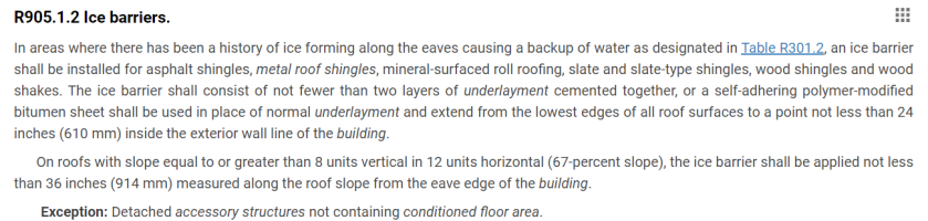

R905.1.2​
In areas where there has been a history of ice forming along the eaves causing a backup of water as designated in Table R301.2, an ice barrier shall be installed for asphalt shingles, metal roof shingles, mineral-surfaced roll roofing, slate and slate-type shingles, wood shingles and wood shakes. The ice barrier shall consist of not fewer than two layers of underlayment cemented together, or a self-adhering polymer-modified bitumen sheet shall be used in place of normal underlayment and extend from the lowest edges of all roof surfaces to a point not less than 24 inches (610 mm) inside the exterior wall line of the building.
On roofs with slope equal to or greater than 8 units vertical in 12 units horizontal (67-percent slope), the ice barrier shall be applied not less than 36 inches (914 mm) measured along the roof slope from the eave edge of the building.
Exception: Detached accessory structures not containing conditioned floor area.

But, I just read the 2024. It is still there. This is from the digital codes online, so is there errata?

I am a bit unclear on the geometry here: I understand "24 inches inside the exterior wall line of building" to refer to a dimension in plan (projection onto the horizontal plane). And the "exterior wall line" to mean the exterior face of the exterior wall, and the "eave edge" to mean the edge of the roof including any overhang.
So for the case of an 8:12 pitch roof with no overhang (eave edge = exterior wall line), every 1" in plan is 1.2" along the roof slope. That means the main requirement extends 29" along the roof slope, and the second paragraph just says to extend it 7" farther. But if you have any roof overhang, or if the slope is steeper, the effect of the second paragraph will be reduced or eliminated. E.g. for an 8:12 slope roof with a 7" or greater overhang, or for a 14:12 or greater slope roof with no overhang, the second paragraph will always be satisfied if the first paragraph is.
Is that all correct? If so, it seems like the second paragraph would rarely make any difference.

The second paragraph relaxes the first for steeper roofs....And maxes out at 36" basically....
There's no language in the second paragraph stating that it is a relaxation of the requirement in the first paragraph. So the second paragraph is simply an additional requirement. Both requirements apply; whichever requirement is stricter will control.

It's supposed to...but like most other changes these days...Poor wording.....You should never need more I&W on a 20 pitch than a 5 pitch.....If the first paragraph governs, you do....
It's supposed to
Maybe (I haven't followed the code change process), but if so, the wording is incredibly dumb. All they would need to do is put "Exception:" in front of the second paragraph to make it clear it overrides the first paragraph.
Given that in the 2021 IRC the last sentence (what is the second paragraph in the 2024 IRC) included the word "also," it was clearly an additional requirement then. So anyone approaching the 2024 text with that prior knowledge is likely to read it as still an additional requirement.
Also, it doesn't make sense as a replacement for the first paragraph. If I have a 20.7:12 (60 degree) roof with an 18" (horizontal projection) overhang, then the 36" requirement from the eave edge ends at the exterior wall line. So if the second paragraph were the only requirement for steep roofs, there would be no ice and water shield required over the wall plate itself, which is presumably the most important location to provide it.
So it really only makes sense as an additional requirement, one that rarely controls.

Per codes.iccsafe.org, the word "also" is in the 2021 IRC but not in the 2024 IRC. Going back to the OP, that, along with the addition of a paragraph break, is the only change in R905.1.2 between the 2021 and 2024 IRCs. A change for clarity, not a change in meaning, so not "key."
