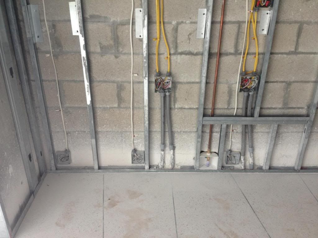

And you guys may have some fun with this, the 3 boxes at the bottom of the following pic are for the refrigeration units, 4.5A each. 14/2 OK in a kitchen?
14/2 is OK for the fridge(s)
210.52(B)(1)
Exception No. 2: The receptacle outlet for refrigeration equipment shall be permitted to be supplied from an individual branch circuit rated 15 amperes or greater.
