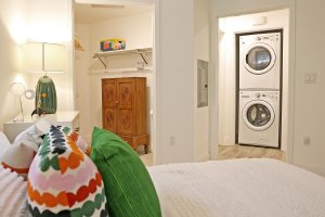

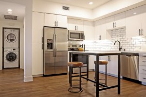

Question: do these bonds now mean this private project, probably built to CBC 11A standards, should now be considered as "public housing", subject to all of the accessibility requirements in 2010 ADAS and CBC 11B?
The photos show 36" counters, no workspace next to the oven, a stacked dryer, a potential 50% kitchen storage problem, and it is likely bathrooms were designed too small to meet ADA.

It's not the bonds that matter, it's the ownership. The article opens up by stating that "the 335-unit complex was acquired by the Housing Authority of the City of Los Angeles, ..."
In another life, I worked as staff architect for a municipal public housing authority. The authority purchased three formerly private complexes while I worked there. Once the properties were owned by the housing authority, they were indeed public housing.
For example, the housing authority is receiving money from the Department of Housing and Urban Development that will subsidize rent for many of the property’s tenants that make very low or extremely low incomes.
I know that tenant-based Section 8 vouchers don't trigger ADA or 504/UFAs compliance in the units.
But if the vouchers are project-based (i.e. the vouchers remain with the units even when the tenants move out), then it is definitely subject to ADA / 504.
Section 8 is privately-owned. The tenants get vouchers from a public housing authority to subsidize some, most, or all of the rent. Section 8 doesn't apply to properties owned by a public housing authority.

Hello Yikes,
Very sharp observation in my book.
If this facility was built after 1991, all the units on the first floor are covered by the Fair Housing Act federal law. If there is an elevator, all the units accessible by way of the elevator will be covered by the Fair Housing Act. Trigger for ADA residential facility compliance comes if the funding is through the state (ADA Title II kicks in) or if these are ever rented out as transient lodging ADA title III kicks in.
