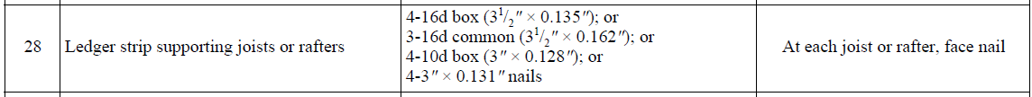

The devil is in the details, and your design may not be prescriptive at all, but ledger strip attachment is address in the nailing schedule of the IRC in Ch. 6..
