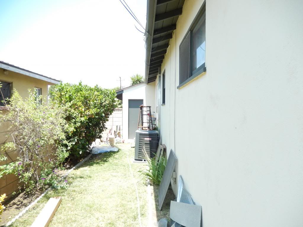

So would you ask them to level the unit?
The unit is out of level more than the picture shows.
ICE,
I don't think workmanship is your job. You have enough to do with codes and safety.
On a final, yes! Level the unit.
Replacement install by contractor, yes, level the unit.
Could be the homeowner's rights to be lazy.
until you final the building, require it.. after that it's a contractor warranty issue.

HmmmmDoes the manufacturer have specifications?
Sent from my iPhone using Tapatalk
Compressor manufacturers require no more than 2% from vertical. It is important and is listed on every piece of equipment literature in the installation instructions. Not only bearing failure but some manufactures compressor motors are mounted on springs internally. When the torque of the motor takes place at start up the motor will bang against the compressor shell and when it shuts down.
