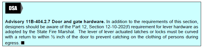

One more update on this old thread. The California Access Compliance Reference Manual now offers the advisory below:
California Referenced Standards Code 12-10-202(f):​
"Levers. The lever of lever actuated latches or locks shall be curved with a return to within 1/2 inch (13 mm) of the door to prevent catching on the clothing of persons during egress.​
Cross-reference Table: Part 2, Sections 407.4.1.1, 1010.1.4.4, 1010.1.9.1, 1010.1.9.4 Part 9, Section 1010.4.2​
The code cross-references are out-of-date. The actual current code reference is 2022 CBC and 2022 CFC 1010.2.2, which states:
"[BE] 1010.2.2 Hardware
Door handles, pulls, latches, locks and other operating devices on doors required to be accessible by Chapter 11A or 11B of the California Building Code shall not require tight grasping, tight pinching or twisting of the wrist to operate.
These design requirements for door handles, pulls, latches, locks and other operating devices, intended for use on required means of egress doors in other than Group R and M occupancies with an occupant load of 10 or less, shall comply with SFM Standard 12-10-2, Section 12-10-202, contained in the CCR, Title 24, Part 12, California Referenced Standards Code."
