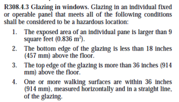

This fixed window lies in plane with a floor which was stretched across an entry foyer. Also, there is 4”+ gap between the floor and the glass. It is just float glass.
Do you agree this is a life safety issue?
I requested, as building official, a barrier be installed across the opening while we figure out the next steps.
Please let me know your thoughts. D

It is certainly a hazard, the question is whether there's any code section that it violates. As a window, I think not:
Unless the glass measures more than 9 s.f., this section won't cover it. But, you wrote that the floor is infill over a former foyer. So there's a fall issue as well as a broken glass issue. And I see a child's toy there, so there must be at least one young child (or grandchild) around. The glass could be considered to be part of a a guard.
It's a bit of a stretch, but I can't imagine parents or grandparents NOT wanting to keep their kids/grandkids safe.
On the other hand, the glass apparently extends below the floor, so the actual pane is likely quite a bit larger than the portion exposed to this room.

Welcome to the forum!....As CC said likely does not need safety glazing, but could need fall protection per the MI section......
I didn't say it likely does not need safety glazing. I'm inclined to think that it does., based on either the size of the pane of glass or on the fact that it could be construed to be part of a guard for an elevated walking surface.
