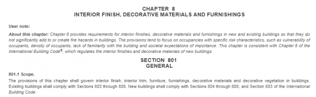

The 2018 Section 801.1 "The provisions of this chapter shall govern interior finish, interior trim, furniture, furnishings, decorative materials and decorative vegetation in buildings. Existing building shall comply with Sections 803 through 808. New buildings shall comply with Section s 804 through 808, and Section 803 of the IBC."

My 2018 does not have the words "furniture or furnishings" in the scope

FV, read Section 801.1 that you posted—it does state “furniture, furnishings...”
