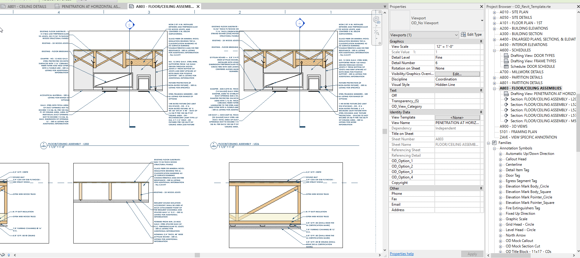

Thanks everyone. Per this conversation, ff anyone's interested, added a few floor/ceiling UL assemblies to our open source Revit template
https://github.com/OpeningDesign/OD_Library/blob/master/BIM/OD_Revit_Template.rte
