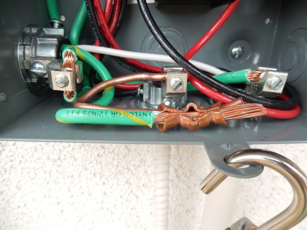

Can someone tell me if this crimp is being used correctly. Any listing info would be helpful.
Thanks
jar546 said:
Hmmmmm, Solid and Stranded on the same crimp sleeve......................
Never seen one that was listed for that in that size. Also poor practice not to place the indenting part of the tool directly opposite of the seam.
Upon further review, what possessed the installer to crimp on the solid instead of taking the stranded right to the bond bushing?
jar546 said:
Hmmmmm, Solid and Stranded on the same crimp sleeve......................Me have to check with the manufacturer
Burndy?
That was my first thought too. I don't know who made it.
That's a good question Chris and I am almost embarrassed to admit that I hadn't noticed that. It's a solar contractor so the person that meets me for inspection seldom knows anything about the work.
Do you know what companies make the crimps and tools?
I'm going to go out on a limb here and say that that
crimpable, barrel butt splice is too small for the size
of conductors being joined together, or conversely,
...the conductors are too large for that size barrel.
REASON: All conductors being joined together
should be fully within the barrel being used, when
crimped, or at an acceptable margin.
http://www.molex.com/pdm_docs/ats/TM-638000029.pdf
See Page 20 of 24.
north star said:
: - :I'm going to go out on a limb here and say that that
See Page 20 of 24.
That's a step in the right direction and your observations are correct, thanks. Now if I can find the actual product. I asked the contractor to produce a listing but I would like to be prepared.
