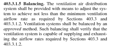

I would have the same concerns as North Star.
System has to balance and without adequate return air from the supplied areas it's not going to be compliant.
Options are; undercut doors to the design professionals requirement, wall or similar thru transfer grills to the common hall or provide ducted returns. While not the best approach from a comfort standpoint it will work when the balance calcs come back.
The preference we see is undercut doors.

1018.5 Air movement in corridors. Corridors shall not
serve as supply, return, exhaust, relief or ventilation air ducts.
