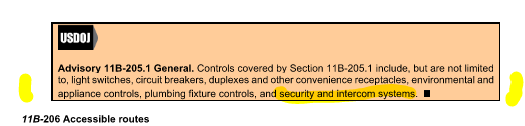

There is an exception in 11B-205.1 for "operable parts used only be service or maintenance personnel". The USDOJ further clarifies that "security systems" are included in the controls covered by 205.1, so therefore the exceptions would also apply to security systems, and locks are but one component of a system for security.
So the main difference between IBC 1010.2.3 and this exception #1 in 11B-205.1 is that the CBC would only allow it where it can be determined that the lock controls will be utilized solely by service or maintenance personnel. There are facilities where it is solely the job of the maintenance personnel to unlock the doors in the morning and lock them up again at night (especially with the "this door to remain unlocked during business hours" signage); likewise for operable window parts.
