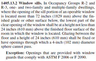

I'm having a hard time understanding if windows above grade floor (R-2 occupancy) are required to have limited openings under the Massachusetts Building Code (2009 IBC).
