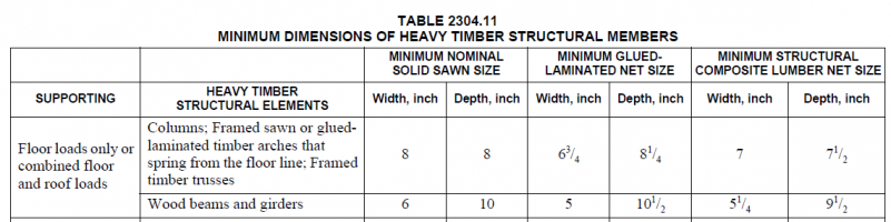

Not really and the code recognizes that in Section 2304.11 with limitations on the different materials and sizes and how they are used.
2304.11 Heavy timber construction.
Where a structure, portion thereof or individual structural elements are required by provisions of this code to be of heavy timber, the building elements therein shall comply with the applicable provisions of Sections 2304.11.1 through 2304.11.4. Minimum dimensions of heavy timber shall comply with the applicable requirements in Table 2304.11 based on roofs or floors supported and the configuration of each structural element, or in Sections 2304.11.2 through 2304.11.4. Lumber decking shall be in accordance with Section 2304.9.
It would have to be a 5 1/4" x 14" LVL. You can't count thinner pieces fastened together; it has to be one solid piece.
see the table I posted above hans....With glu-lam or SCL listed...Code doen't actually say whether they could be "field assembled" or not.....

good point, I guess if LVL's and LSL's are mentioned, they're typically 1.75", so one could infer that multiple members can be used to achieve the minimum size, but as you said the code doesn't specifically say that......in the end, it's not a huge deal if I have to wrap the beam in sheetrock, we're talking about a 6' section on each side of the shaft and just use simpsons fire wall hangers.....funny, that's a new section added to the code, I'm actually using the previous code for this project, I would imagine I could reference this section since it's not addressed in the old code
Absolutely...and if Joel doesn't buy it you can get it formally through the State...
And how are you connecting the multiple members together? Will the connection pass a one-hour assembly test?
Just playing devil's advocate here so you are not zeroed in on meeting just the size of the lumber. Remember heavy timber works because of the charring effect on a large single piece of lumber essentially does not reduce the structural strength significantly. Not sure if that would apply to multiple 1.75" LVL's fastened together. You may have to provide a little more documentation to CYA
