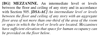

I don't know enough about your building to determine whether it qualifies as a "mezzanine portion of the "first story above grade plane", or whether is is the "second story above grade plane". See table 1006.3.3(2) below.
Thank you Yikes!
In regards to Table 1006.3.3(2) wouldn't it be considered "First story" above grade plane? Either way "Second Story" or "First Story" I'm still under the Occupant load and distance (If I understand what I'm reading, I can have 100' travel distance because the entire building is sprinklered (Footnote b)
Here is kind of an overview of the entire building. Overall building is 22' tall. The finished floor is at 10'. Most of the entire building is a single level. The area in green is the second level.
Thanks everyone.
I tried to educate myself to the term "Story above grade plane", and I think I get it now. In cases where the "grade plane" is perfectly flat (no slope), story's are exactly what a layperson thinks. Ground level story is the "First Story Above Grade Plane".
It seems to me that "Above or below" grade plane gets complicated when a building is on some sort of slope, and I would think the significance is important If you were trying to build something with more floors than local code allows. If your on a slope, you might be able to call the "first floor" a "below grade plane", and get away with having 3 floors where a local code only allows 2 Stories above grade.
So in my case with a perfectly flat site, the ground level is "First Story" above grade plane, and the upstairs is the "Second Story" above grade plane.
Did I get that right?
As to the Mezzanine vs. Second Level, could you please explain?
A little more information. The area of the building that is in the green area as well as the building area north of it has a roof at 22'. The building section that is to the east of the green area has a roof at approximately 17' None of the upper level is "open" to the floor it is above. The "first level" is at grade level.
In the context of the discussion we are having, I don't understand the ramifications of each, but here is my try:
Section 1006.3 specifically addresses exits from "Stories", not mezzanine.
If it is called a "story", then I would think as you pointed out, that 1006.3.3(2) would say Occupant load of < 29 and max travel distance of 75' and a single exit is permitted.
If it is called a "mezzanine", what governs the exists / staircases ?
As a layperson, it seems to me that it has to be called a story? What am I missing?
