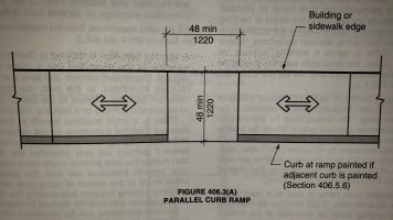

I suggest a ramp up to landing and back down opposite side, parallel to store front, width of landing depth, and a railing along whole thing on street side of ramp and landing. It eliminates multiple trip hazards and creates very minimal sidewalk restrictions and obstructions, and treats everyone equally.

The best solution that I can suggest is to remove 20 feet of sidewalk and replace it with a compliant, 4 foot landing height in front of the door that extends to the curb, with 2% sloped sidewalk on each side of the landing, and extending the full width of the sidewalk. That way it does not require edge protection, handrails, or any steps. Best of all, it eliminates any obstruction to the pedestrians using the sidewalk.
(See FIGURE 406.3(a) in the ICC A117.1-2017 STANDARD AND COMMENTARY)20210928_071247.jpg

Inspector, …that parallel curb ramp works, except the landing height is an inch short., and the city will not make any changes. The best we can hope for is for them to approve and we change at our expense. And actually, …we have a side battle going with the landlord: the lease states its his responsibility, but he is resisting.

Is a straight line from threshold to curb steeper than 2%? Didn't look like it in photo, but can't tell. Yes, it's the whole sidewalk !
The continuous ramp up-landing-ramp down that Gift suggested and similar to what I said seems best of difficult problem, but with a railing. I'm not sure why Gift's landing is 4' from wall rather than 5' - I may be missing something - but at 5' the behind the door issue is minimal., and next, A117.1 I think increases that from 60" to 64 or 66", I'd have to check.
