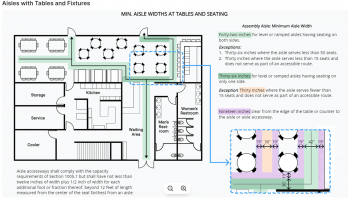

I apologize if this is a really rudimentary question, but I've been looking for a code section for 2 days and it's driving me up the wall.
I KNOW there's either a code or accessibility section somewhere that talks about the minimum width between 1 side vs 2 sided access to...something. Service counter? storage? anything?
Example: Minimum distance between two storage shelves back to back, vs a storage shelf and a wall.
Anyone know the code section I'm looking for?

It is both a code and an accessibility issue.
36 inches is the minimum accessible route width, with an exception that can reduce it to 32 inches for lengths not greater than 24 inches (Chapter 4 ADA and ANSI).
In employee work areas, only common circulation paths must comply with the accessible route requirements.
Thanks all for your replies, I think I found the diagram I was originally looking for:
Granted, this isn't exactly what I had asked originally. I also found a snippet in the California Fire Code pertaining to minimum aisle width in storage (closer), which is 44" (sprinklered, non high-pile).
I think I have my answers now. Thanks all!
