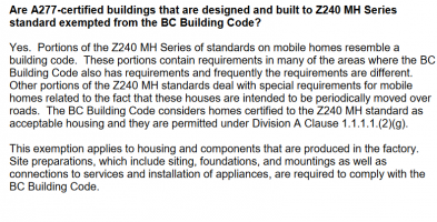

From the BSSB:
So to apply Pt9 to these buildings seems to me a stretch. And because I live in a swamp with clay soils that are very prone to frost jacking, there is always differential movement between trailers and additions that leads to mould from either bulk water entry or air barrier failure.

OK, so with exception of foundations, siting, and mountings, these buildings are exempt from the BC code.
That is a BC specific amendment to the code and does not exist in either the national code or the Ontario code (the only other two I own).
We should differentiate between the CSA 240.2.1 (structural requirements) and the CSA 240.10.1 (site anchorage). It appears that the structural requirements are dealt with differently between our codes.
The CSA Z240.2.1 that deals with structural requirements is not referenced at all by the national code and only referenced in Part 3 for the Ontario code. The BC code does reference it is Part 9 through.
Now we are a little bit better equipped to answer the original question: can modifications happen to these buildings? Yes, provided the modifications comply with CSA Z240.2.1.
