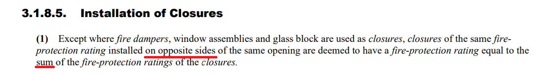

This is from Ontario Building Code Division B. How to interpret it? Does this not apply to window assemblies, glass block or wired glass in a door closure? (the door can be seen as the larger closure while the wired glass in the door is the smaller closure)
I'm not in Canada, but I would interpret that to refer to what the IBC refers to as the "opening protective." If the opening is a doorway, the opening protective is the door, so you would be talking about using (for example) two 1-hour-label doors to protect a single opening in a 2-hour wall, or two 90-minute doors to protect an opening in a 3-hour wall.
I'm assuming that the Ontario Building Code uses "closure" to mean the same as the IBC "opening protective."
Understood.
My question and doubt now comes down to: can the the fire resistance rating of the glazing (vision panel) in a fire door use the 3.1.8.5.(1) sum rule in my last post?
I don't know how it's done in Canada. In the U.S. the door assembly, with the glazing and stops in any vision panels in the door, are tested as an assembly.
What that is speaking to is when you have an assembly where there are layers of wired glass or glass block on each side. very similar to the component additive method in concept.
Normally this is done where assemblies are thicker and the additional layer is required to maintain the continuity of the fire separation because the fire assembly must be rated from fire exposure from both sides for walls.
Likely not applicable on a door as the glass is in the same plane as the door.
I'm not sure I can agree that this would apply to glazing in doors at all. That rating should be coming from what the door achieved when tested under CAN/ULC-S104.
It is arguable because normally window and glass block ratings come from CAN/ULC-S106, but there are provisions for rating under the code for wired glass and glass block as well. But I don't feel those rating provisions apply to doors.
In Canada, you cannot field modify a fire rated door at all. If you want a window in it, you order one with a window. The door had to be tested with the window in it, so the code would naturally be silent on the issue.
Is field modification allowed for small area like vision panel?
I believe the limit on glass area in a fire door is due to the radiant heat transmitted through the glass. I don't think a second layer of wired glass would block any more radiant heat and increase the fire rating.
