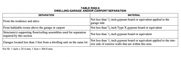

Several times the OP has mentioned that he just might sheet rock the wall between the house and the garage. Can someone tell us if the NC code would require that as does the CRC.
R302.6 Dwelling/garage and/or carport fire separation.
The garage and/or carport shall be separated as required by Table R302.6. Openings in garage walls shall comply with Section R302.5. Attachment of gypsum board shall comply with Table R702.3.5. The wall separation provisions of TableR302.6 shall not apply to garage walls that are perpendicular to the adjacent dwelling unit wall. A separation is not required between the dwelling unit and a carport, provided the carport is entirely open on two or more sides and there are not enclosed areas above.

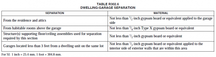

Standard 2021 IRC​
R302.6 Dwelling-garage fire separation.​
The garage shall be separated as required by Table R302.6. Openings in garage walls shall comply with Section R302.5. Attachment of gypsum board shall comply with Table R702.3.5. The wall separation provisions of Table R302.6 shall not apply to garage walls that are perpendicular to the adjacent dwelling unit wall.
TABLE R302.6
DWELLING-GARAGE SEPARATION
SEPARATION​
MATERIAL​
From the residence and attics​
Not less than 1/2-inch gypsum board or equivalent applied to the garage side​
From habitable rooms above the garage​
Not less than 5/8-inch Type X gypsum board or equivalent​
Structure(s) supporting floor/ceiling assemblies used for separation required by this section​
Not less than 1/2-inch gypsum board or equivalent​
Garages located less than 3 feet from a dwelling unit on the same lot​
Not less than 1/2-inch gypsum board or equivalent applied to the interior side of exterior walls that are within this area​
