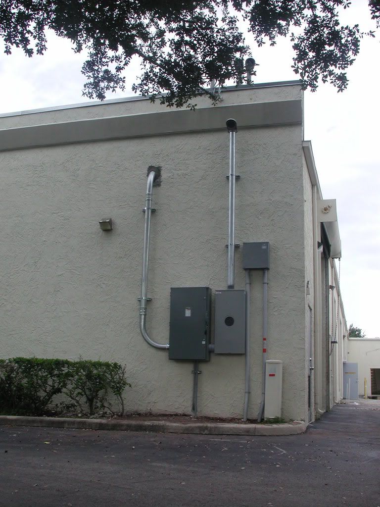

I have an issue thats bugging me. I'm installing a new service disco that has been through 3 revisions and 2 plans reviews. First set of plans had a 400A shunt trip main as this disco is outside directly behind 2 existing 600A mains inside. I would have placed the EPO between the two 600's inside.
Latest approved set of plans now has me installing a 400A fusible main outside. This morning I was telling the GC he would be receiving an E-mail from me explaining that this is a violation of 230.72. He is questioning this so I pull out the book and read this aloud. A lay-man standing with us points to the corner of the building and says, "Whats the problem, they are all grouped on that corner of the building?".
I believe most of us here would agree that even having to walk a dozen steps outside to open the 3rd disco in not grouped, just throwing this out there as it did pass plans review.
The following is a pic of the service. The two existing 600a mains are directly behind what you see here. (The breaker enclosure is coming down tomorrow and being replaced with the fusible disco)

What the GC and the passerby think is not relevant. It's what the inspector thinks.
Agree with 480sparky!......IMO, "grouped together" does not mean ' ...some inside
and some outside '!.....Was the picture of the installation shown, the one drawn
on the "passed" plans review?

I too do not believe this particular arrangement would be considered "grouped". That being said, it may be possible to get special permission for this installation if considerable substaniation or circumstance could be explianed as to why this arrangement is necessary and can be made safe.
For example, lets say the electrical room simply has no more room for new equipment. If the occupancy in question is under single management with qualified in-house employees & permanent placards are placed on the service enclosures identifying the location of the other service disconnecting means, then maybe, just maybe this could be approved.
If the only reason for this arrangement is beacuse it is easier to install or the engineer doesn't know what he is doing, then I would likely hold to the letter of the code.

Update
I had the EI out today to look at this, I didn't bring up 230.72 during our conversation. He told me to wire it up, call him back and he would release it to POCO.
FWIW, here is a pic of the breaker enclosure changed out to the fusible disco as per revision 3.
