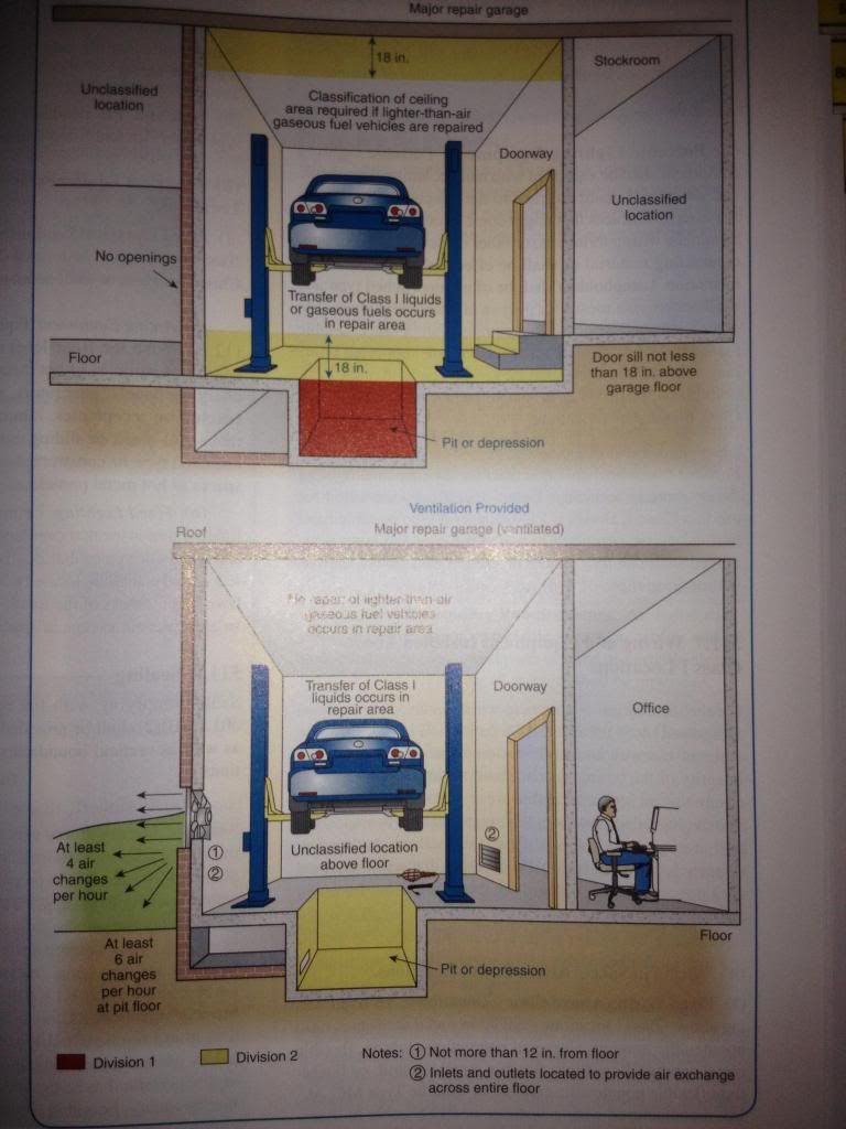

I'm an Architect, not an engineer or an electrician so this is new to me. But I'm working on a water treatment plant and the electrical engineer is telling me that the floor for the attached maintenance garage to the facility has to be 18 inches below the facility floor. This is due the with a requirement that certain services, in this case electrical, have to be a minimum of 18" off the finish floor. Our electrical service room is 110' away from the garage through 2 doors in a hall through the administrative area across a 40' atrium space, then down a 20' corridor to the door to the electrical service room.
This seems ridiculous.
I read through the requirements in the NEC and I understand the reason for this requirement if the service was in the garage area and I don't know if even then it's required because I would consider this a "Minor Repair Garage" per the code definitions.
Any help with this would be appreciated.
