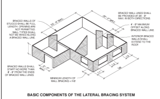

You may need interior bracing wall to resist Lateral loads, and to transfer those loads from the roof to the foundation.
