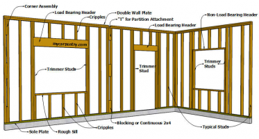

It still has a header, just not nearly as substantial. Here's a picture I found on the internet, I will say though that when I've seen this in reality it was a double 2x and criples.

Gable end walls are usually not bearing. Gable end walls are usually built the same as the bearing walls. Now if the project is tract housing that has been value engineered, the gable end walls might have skimpy headers but not much else is different than bearing walls. Another consideration is braced wall segments which occurred often in gable end walls.
