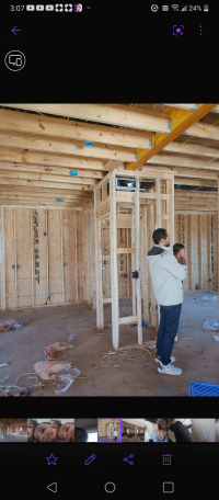

Im building my home and my contractor has added the pantry in the middle of the living room and he says it is important for support and already has duct and electrical wires on it , is there any suggestion to replace it and how much does it cost, also the dry wall has been installed but i don't have photos after the dry wall

Im building my home and my contractor has added the pantry in the middle of the living room and he says it is important for support and already has duct and electrical wires on it , is there any suggestion to replace it and how much does it cost, also the dry wall has been installed but i don't have photos after the dry wall, i added another photo for the home plan, the pantry was supposed to be in the red circle but he moved it to the green dot, can it be replaced by column without moving the duct

So he’s saying the triple yellow beam above is over spanned and needs a mid-support? How is the beam shown on the plans?

Perhaps you can provide a screen shot of the framing plan. Understand that the builder works for you. The pantry doesn't appear to be providing support to the beam in any practical way. Pictures of the other side of the pantry and the bearing points would help to understand what happened...that and the framing plans.
Just because the drywall has been installed is no reason to let this stand and you might forever regret having a free standing pantry in the living room.

The duct can have a ceiling register. Do the plans show a column? What about a footing for a column? What mistake has resulted in a need for additional support? Is there a permit with inspections in Antioch, Tennessee? Was the person that named your state afflicted with a stutter? Maybe from Mississippi?

Yes there is permit and inspections in TN and they are passed, and this pantry location was not in the original plan and there were no column also , i attached the photo

The framing is not per the plans that you show us. It may match the plans submitted to and approved by the building department. If your plans match the building department plans then the inspection should have never been passed until a revision was resubmitted. You are the owner, you control the money. If the house is not the way you agreed to and not on the set of plans you signed your contract on, you need to contact the contractor to get this sorted out. I would go to the building department to see if the plans they have match what you agreed to. if they don't then ask for the building official and ask why the inspection was passed when the framing and layout did not match the approved plans. Let them know you are not happy with the results. It is never too late.

Stop the work and get an architect or structural engineer involved. They are not easy to find for limited service jobs like this but call and play the pity card if necessary. This is obviously a major investment for you and you'll regret not getting it right and as planned.
(My guess is contractor made a framing mistake - like beam size or length - and is hoping he can force you to accept this, though I agree with Ice that it doesn't seem to provide proper support.)
Sure it does. He has a double top plate and a white-wood 2x4 almost under the beam … what more could you ask? Well … you could ask for bottom plates 4 ft long that aren’t two pieces butted together …

Note the visible 'bow' in that one stud also...

If the beam over the errant pantry has sagged there is a reason for that. It might be too small and over spanned. It might be the wrong beam per the plans. It might be the right beam per the plans and still be the wrong beam. Given the way that the pantry is framed, I find the contractors explanation suspicious. There's no studs under the beam. Ask the contractor to explain why extra support is required. He has my attention so I'd really like to know why.
You have mentioned a column several times. You shouldn't let the contractor and the building department devise a fix for a glaring mistake. Unfortunately an engineer may be called for. Fortunately that expense would land on the contractor's lap...not yours. Remember that you aren't required to pay for the mistakes of others.
I noticed that there is a wall framed above the beam and that is curious.

The stud was straight until they installed the blocking which was a little too short, and driving the nails sucked in the stud. That’s my story.
I attached another photo and the house plans , i think he added this pantry to cover the duct work run under the beam, there are two ducts run under the beam ,one located in the pantry and one goes to the dining area, i will try to see if we can just leave the drop ceiling to cover the duct and wire works and remove the rest of the walls, wish me luck and thank you all

The corner stud almost looks bowed as well, as someone else mentioned...is the top plate bowed slightly as well? I can't tell from the pic.
