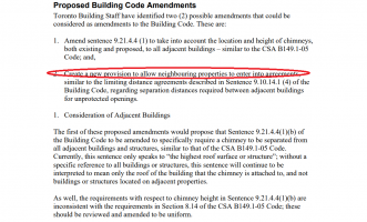

Attached is a staff report from City of Toronto regarding chimney. My question is more about the comments in the second screenshot below. How can the owner of a new proposed construction permit enter into an agreement about the neighbor's effected chimney? Who will pay for the extension or relocating of the effected chimney?
As I understand, unless there is proof that shows that the neighbor's effected chimney has been constructed without a permit, the neighbor (if it's me) would not be willing to pay for any cost to bring his / her effected chimney into compliance with current building code.
Normally, we calculate the limiting distance to the lot line. What the City of Toronto allows is for two private property owners to agree on a different line being used to calculate the limiting distance.
The proposal would satisfy the issues around prohibited locations that are in close proximity to the lot line. There are a couple of issues with this approach. First, unless registered against the properties, the agreements would not be binding on future owners as they would be unlikely to be made aware of the agreement. Additionally, these would be challenging for the municipality to manage without substantial resources.

More of my doubt is about why the owners are willing to enter into such agreement, would they all benefit from the agreement?. Assume an scenario where my neighbor is applying for a new two story house (tear down and infill) which would make my existing chimney uncompliant, why would I enter into such an agreement to do extension or relocating of my chimney unless in the agreement that my neighbor will pay all the costs, and an amount of compensation for my inconvenience?

In that situation, the neighbour would need to have their limiting distance encroach onto your property, which would be what triggers your chimney to be non-compliant. So, for you to sign an agreement, the neighbour would have to compensate you to whatever level you want for having to relocate the chimney and lose the some of the potential use of your property (i.e.: you can no longer build in that area).

My assumption is that the chimney is currently setback appropriately from the lot line and the new building needs a little more room on the other side of the lot line to be constructed legally, but this moves the chimney from its complaint status to non-compliant due to the relocation of the line used to calculate limiting distance. So, to answer your question; the permit for the construction of the new building would be denied and the chimney would remain compliant.

You're not wrong. In the case, the courts held that a permit could not be withheld because the building official thinks there might be a violation someday. Your example is exploring the opposite, presumably the building official could not legally issue the permit because it would permit illegal construction.
In your example, the existing chimney would at no point be illegal. The new construction that is too close to the lot line would be.
