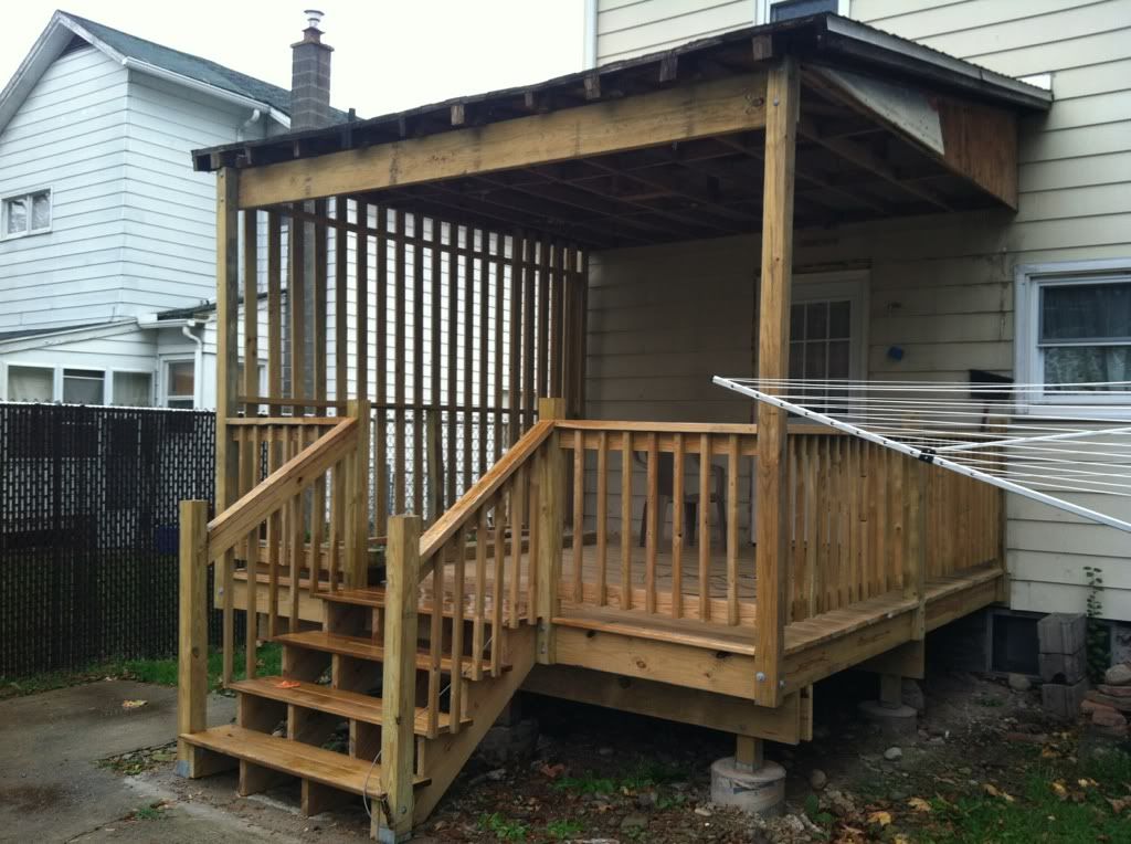

New Deck to replace old covered porch

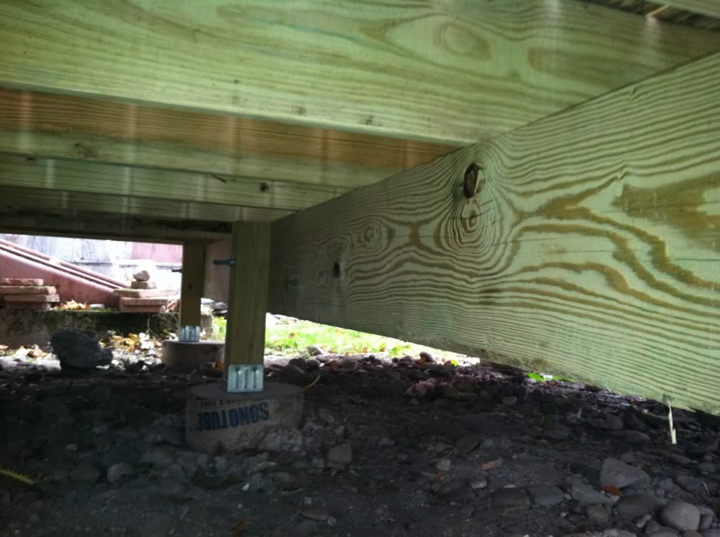

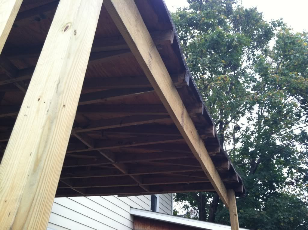

Nice job! Final was scheduled.
Are those lag bolts, inserted in to the 4" x 4" posts, approved fasteners
to sustain the loads of the roof framing / flooring framing / live loads?
I thought that the framing had to be supported on top of the vertical
posts, and not with fasteners in to the sides of...
north star said:
* * * *Are those lag bolts, inserted in to the 4" x 4" posts, approved fasteners
It can probably be hung on the side...just engineer it.....
Do they still sell nails in PA?
Railing required if over 30"?
Is there a beam master in the house?
PC1
This one looks like it could probably saved with some engineering as pointed out. Do some calcs, double up the beam, add some bolts as needed, etc.............
