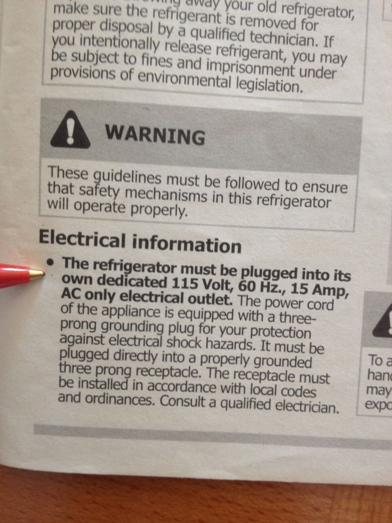

A potential problem I see is the refrigerator on a SABC. All the refrigerators, freezers, ice makers, wine coolers ect I run into state
"Install on a dedicated 15 or 20 amp branch circuit."
I see this wether the appliance draws 1.5A or 12A.
So you would have a violation of NEC 110.3(B) and then the contractor will say
"That's what your handout shows???"
  • Like
Reactions: ICE
210.50 (b) (1) exception 2 allows for the refrigeration to be on an individual branch circuit of at least 15 amps
All well and good, now I challenge you to find a users manual for a piece of household refrigeration equipment that doesn't say this...
Well Chris, only top shelf electricians know about that. I certainly didn't and I have approved a few thousand kitchens with who knows what for the refer....Now I will ask for the dedicated circuit and see what happens.

So the violation is on the person who plugs the fridge in...not the electrician. I do not require the fridge to be present for CO and would have no way of knowing...Back to GFCI vending machine arguement...
