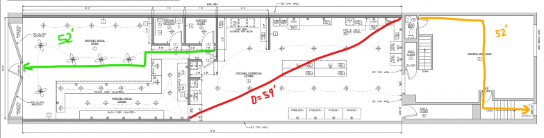

I need some advice on an egress plan. I'm helping a friend for free with their building plans and trying to get them approved by the City plan reviewer. A bit of background info: Building was built in 1860s and last use was general retail B business occupancy. Non-sprinkler building. City uses 2015 codes (IBC, IEBC, etc) There are buildings abutting each side, with a level exit to Main street out of the front door and alley exit off the rear. Just picture your standard small town Main street with long narrow brick buildings. New occupancy is 47 and City so far seems OK with everything I've submitted to them. One comment I got back was needing an egress plan and egress can't pass through kitchens or storage areas.
I've attached a snip from the floor plan with some colored lines for each space. Green is the retail area (OL=38), red is the diagonal of the kitchen (OL=8), and orange is the back mail room (OL=1).

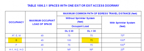

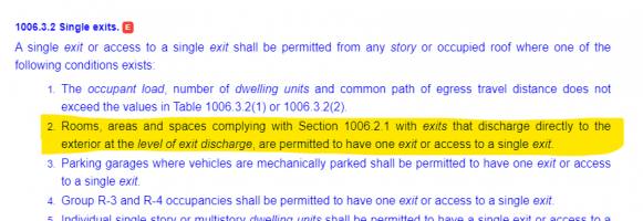

Since the green line is under 75' and discharges directly to the exterior, is it permitted to have one exit?

What about the orange line in the mail room? The room exit is to an exit stair corridor that discharges to the rear alley. The rear portion of the building is about 5'-6' higher than the alley, so that's why there are stairs leading down out the back. Can that mailroom space be permitted to have one exit so that it doesn't egress through the kitchen?
I've uploaded a PDF of the floor plan https://www.dropbox.com/s/3gwobdcrrlqisg2/302-N-MAIN-egress.pdf?dl=0

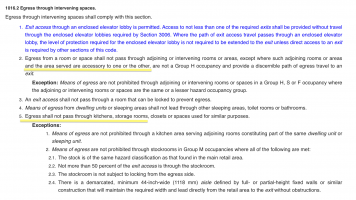

This is 2018 version,,,
Check it against the IBC you Are using
1016.2
Egress through intervening spaces shall comply with this section.
  1. Exit access through an enclosed elevator lobby is permitted. Access to not less than one of the required exitsshall be provided without travel through the enclosed elevator lobbies required by Section 3006. Where the path of exit access travel passes through an enclosed elevator lobby, the level of protection required for the enclosed elevator lobby is not required to be extended to the exitunless direct access to an exitis required by other sections of this code.
  2. Egress from a room or space shall not pass through adjoining or intervening rooms or areas, except where such adjoining rooms or areas and the area served are accessory to one or the other, are not a Group H occupancy and provide a discernible path of egress travel to an exit.
    Exception: Means of egressare not prohibited through adjoining or intervening rooms or spaces in a Group H, S or F occupancy where the adjoining or intervening rooms or spaces are the same or a lesser hazard occupancy group.
  3. An exit access shall not pass through a room that can be locked to prevent egress.
  4. Means of egress from dwelling units or sleeping areas shall not lead through other sleeping areas, toilet rooms or bathrooms.
  5. Egress shall not pass through kitchens, storage rooms, closets or spaces used for similar purposes.
    Exceptions:
    1. Means of egressare not prohibited through a kitchen area serving adjoining rooms constituting part of the same dwelling unit or sleeping unit.
    2. Means of egressare not prohibited through stockrooms in Group M occupancies where all of the following are met:
      1. 2.1. The stock is of the same hazard classification as that found in the main retail area.
      2. 2.2. Not more than 50 percent of the exit access is through the stockroom.
      3. 2.3. The stockroom is not subject to locking from the egress side.
      4. 2.4. There is a demarcated, minimum 44-inch-wide (1118 mm) aisle defined by full- or partial-height fixed walls or similar construction that will maintain the required width and lead directly from the retail area to the exitwithout obstructions.
lose the closet or relocat it to the north into the mail room, the you have a straight shot out to the stairs
Can't do that. It's a mechanical closet with a brick wall.

Just a question, 1. How is the mail room connected with this business??? Same owner???
Just wonder why the case opening, between the two??
And whoever controls the mail room, is allowing access thru it?

2015 IBC snip:
Does #2 trump #5? Would a mail room be considered storage or closet space? In reading the commentary section of the code it states: "A customer means of egress should not be through the working portions of a commercial kitchen behind a restaurant or the stock storage area of a storage room behind a mercantile occupancy..." Should my reply to the City building reviewer quote this commentary? Kitchen staff would be in a high hazard area already and won't be passing through a higher hazard area by exiting through the mail room. I don't even know if you'd call a mail room a storage room.

It's all the same business. Ice cream store makes their own product and ships it nationwide. The opening between the kitchen and the mail room is just an opening in the wall without a door. Just picture a double door opening with door trim around the opening, but no doors. If there is no door between those two spaces, could it be considered one space? The owner won't use that mail room as commercial kitchen (mainly due to the existing employee bathroom opening directly into that space) but also doesn't want to renovate that room with new floor and possibly adding FRP to the walls for the health inspector.
As long as you do not label it storage it is normally not.
I would document back to the city
1. Exiting thru the mail room is only for kitchen staff
2. The mail room is owned by same person as Ice cream place
3. Will be glad, even though not required to yellow hash mark path from kitchen to exit.
plus any other architect language you want to add.
Submit it back and see if it flies.
Will the same people that work in the kitchen be taking finished product into the mail room?????
If do add that comment
2015 IBC snip:
Does #2 trump #5?
Yes if employee use only,,,, normally
