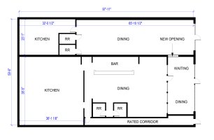

We (architecture firm) have a client who would like to combine two adjacent downtown buildings that share a wall by adding a single opening connecting the two spaces. Both spaces are already restaurants owned by the client. The buildings are on separate lots, but the city has no issue with allowing the opening as long as it is a protected opening. The city says they would accept either fire-rated metal doors, or an opening with an overhead fire shutter (this is what the client would prefer); alternatively, we could have an unprotected opening if the buildings were both sprinklered.
Both buildings are from the early 1900s (but don't qualify as historic), one story, with a long history of being used as restaurants / diners. They are both surrounded on all sides by another lot (it wraps around both of them), so that the front facade is the only possible location for exit doors. The owner would like to preserve the existing layouts of the restaurants, so the opening would need to be near the front of the two buildings (see attachment). The skinnier building only has a single exit at the front and therefore the travel distance from the kitchen exceeds the maximum CPET of 75' for Group A (therefore requiring a second exit if this were a new building). Adding this new opening with the fire shutter wouldn't add a second exit to the space; the shutter would close off the opening in the event of a fire, so the current exiting for both spaces would remain the same.
Combined occupant load will not exceed 250. The total A-2 floor area would be ~5500 SF, which would trigger sprinklers (assuming something points us to Chapter 9 of the IBC), but we could always have the smaller kitchen be a separate fire area if needed.
I have not used the IEBC prescriptive compliance method before, but having just read through it, it seems like this would be the most straight forward method for this project. I'm not seeing anything that would require us to fix the CPET issue. There is no change of occupancy, the occupant load will be less than 300, and both buildings are already accessible (both having been renovated not too long ago). But this seems too easy. Am I missing something? Are there any code issues with connecting buildings on two separate lots that I should be aware of in general?
Looking again, maybe this would count as an addition, since floor area is being added via the connection, though technically these are still different lots and the shutter would close in the event of a fire, so I'm unclear on whether or not that would apply...
Any feedback is appreciated! I've attached a diagram for reference (also embedded below).
What you are missing (I think) is that the IEBC is intended to apply to "an" existing building -- ONE building. You have two buildings, on two separate parcels with a zero fire separation distance. I think the IEBC doesn't directly address that. Under the 2015 IBC, the opening is not allowed:
With the party wall being on an actual lot line (not an imaginary lot line), you can't ignore Table 705.8. Remember, the underlying premise of the IEBC is "Don't make an existing condition worse." By introducing an opening in a party wall on a lot line where there is no opening, you would be making it worse.

Yankee Chronicler - Thanks for your feedback. If these two lots were combined, that would resolve this concern, right? Would that trigger any additional issues? The combined area of the two buildings is less than the maximum allowable area.
steveray - Wow, gotta love weirdly specific exceptions! Seems like this fits our situation, right? The city has asked that a contractual agreement be documented between the two properties, with the understanding that the opening would be demolished if the agreement came to an end, so it seems like this must be why they are ok with this opening being added despite the zero lot line issue mentioned by YC.
Looks like this exception is not currently in the NC code; however, the new 2024 NC codes (based on the 2021 IBC codes) will be published on Jan 1, likely with that exception included.
First you need to determine if it is indeed a single "Party Wall" or perhaps two exterior walls that are also fire barrier walls.
This is the only code section that indicates what a "Party Wall" is and its function. What is a "Joint Service" function between 2 buildings? IMHO it is a single wall providing bearing support for floors/roof or fire separation. If you have two walls and each wall provides providing bearing support for floors/roof or fire separation then you do not have a "Party Wall' and 706.8 could be applicable. As far as CPET is concerned it was not a code requirement prior to the ICC and unless the IEBC sends you to that specific requirement in the IBC it is not an issue.
