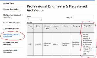

A PE hired to repair a 7 sort building erred in marking load bearing column as decorative, even saying temporary supports weren't needed. Not sure if he was onsite when the work occurred leading to the collapse. No one was killed, and no major injuries.
The engineer was suspended by the city and fined $10,000. Then the civil actions will start as 170 occupants were forced to evacuate.
'Negligent' engineer whose botched inspection led to NYC apartment building collapse agrees to fine, ban https://tiny.iavian.net/1yppb
I read that and was surprised the penalty was so insignificant. Do you suppose if someone had been killed, it would have been different? I would have thought that error would get registration revoked at least a few years if not lifetime. It seemed like they just can't be hired by NYC for inspections for a few years.
Is QEWI just the city inspections? And he can still practice engineering?
A QEWI is a city-mandated periodic inspection of an existing facade conducted by a private 3rd party.
Key clarification: this QEWI engineer did not design the building, and is not the engineer of record for the building.
At question here is his ability to evaluate every 5 years the structural stability of existing facades that were designed by other people, looking for the potential of elements to fall off and injure people below.
So in this settlement, they are focused on his 3rd party forensic inspection abilities; they are not (yet) questioning his legal permission or abilities to engineer new buildings, or to inspect them.
