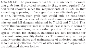

24.2.8.1.2*
Grab bars shall not be required in showers where the transition from the room floor to the shower floor does not exceed 0.5 in. (13 mm) in height and all shower surfaces are slip resistant when wet.
The asterisk denotes additional commentary in the NFPA 101 "Annex":
Now let's look at Annex commentary on A.24.2.8, where they state it is not about nonambulatory (e.g. wheelchair) users.
