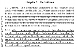

Here is an example of a Florida specific change. This is what keeps the Building Department away from the FFPC unless the BD has personnel that are certified as a Fire Safety Inspector.
