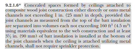

I just dealt with this with a building using NFPA 13. Now, I'm using Canadian Codes for what a fire block can be - usually its things like solid lumber, plywood, osb, regular gypsum, etc. In this particular case the client was intending on using a ULC-tested insulation product (due to the requirement for sound attenuation), which under our codes has met the CSA standard required to serve as a fire block. All they had to do was run the insulation from the ceiling to the underside of the floor deck at periodic intervals (as in, run a batt vertically next to a web joist, with the understanding that the batts in the remaining part of the cavity would hold , or cut down a batt here and there to close the space.
It's worth noting, however, that the language says to measure "from the top of the batt insulation." The architect told the client to fireblock at every fourth joist because they had calculated the volume without factoring in the insulation. When I factored in the insulation, the spaces were vastly larger. (Think 12-13" tall web joists with two layers of batt insulation.
But wait, there's more.
Also worth noting in NFPA 13 is the following:
Note that this clause does not require insulation to go from ceiling to the underside of the roof deck; just the underside of the top chord. A standard 2x3 or 2x4 top chord is 1.5" thick, so if the insulation comes to 1.5" of the floor deck, everything is fine.

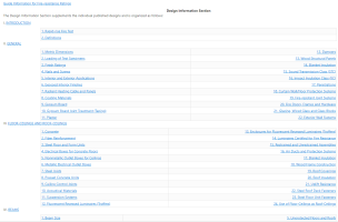

I looked at the Canadian version and it seemed scarily sparse....
There are a lot of UL assemblies that are also ULC tested. Plus we also have what's called a "component additive" system that can provide a fire-resistance rating based on providing a time to each bit of an assembly.
Further, for modest construction, there are umpty-gazillion accepted generic assemblies that are essentially tables in the Code.
I was speaking mainly about the general notes we see in the beginning I didn't see this there:
