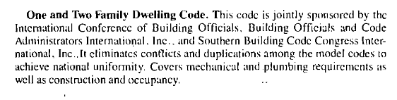

1979 UBC
CABO was used in lieu of the Legacy Codes and recognized a two unit townhouse versus the three required by the IRC. A Townhouse unit is usually easier to finance and insure than a two unit duplex condo.
CABO Definition
Townhouse: Townhouse is a single family dwelling unit constructed in a row of attached separated by property lines and with open space on at least two sides.
