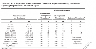

NFPA 58 Question for LPG Tank

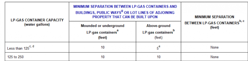

Table 6104.3, less than 125 gal, foot note "e" Items 2,3 and 4.
PRV discharge, minimum of 5-ft horizontally from building, 5-ft from exterior source of ignition an 5-ft from adjoining property that can be built on.
Information I provided came from the 2021 IFC. (NFPA 58 is listed under section 6101.1 Scope).
(NFPA 58, Appendix B if adopted, you will need to view if you have that code)
Sorry, I think Jar wanted you to view the NFPA section.
For whatever reason I couldn't get to 58 yesterday but today I can. I'm usually in 101 on the daily... anyway, wouldn't this be covered in 1 rather than 58
The code always takes precedent before the referenced standard when specified.
2018 IFC
6104.1 General.
The storage and handling of LP-gas and the installation and maintenance of related equipment shall comply with NFPA 58 and be subject to the approval of the fire code official, except as provided in this chapter.
6104.3 Container location.
LP-gas containers shall be located with respect to buildings and lot lines of adjoining property that can be built upon, in accordance with Table 6104.3.
TABLE 6104.3
LOCATION OF LP-GAS CONTAINERS
5 feet
