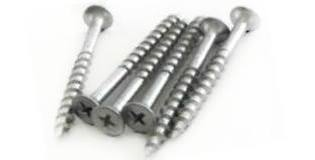

I'm way less concerned about the wiring than I am that goofy hanger with the drywall screws in it.
Non-bearing, Probably could have been a couple A-34's.
They look more like flat head wood or deck screws
The Drywall screws I usually see are Black or Brown
I'm way less concerned about the wiring than I am that goofy hanger with the drywall screws in it.?
Missed that. Its also fastened through a nail plate,which means it’s probably at the ends of 2 boards ... so the fasteners are probably not biting into much wood.
