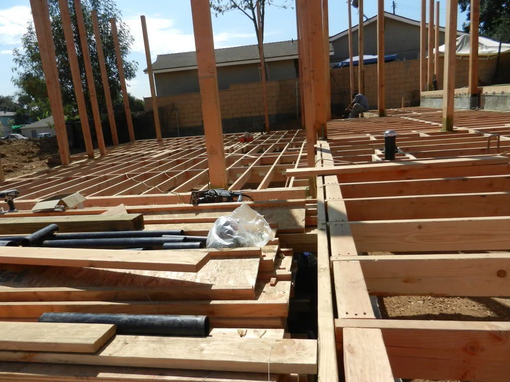

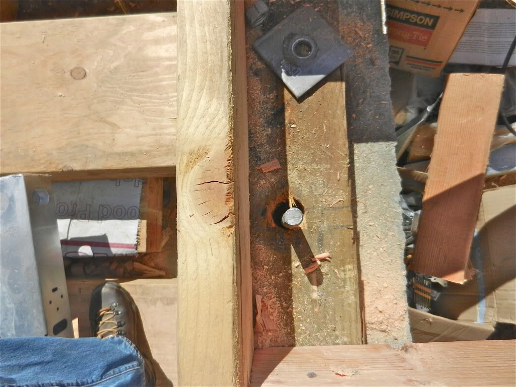

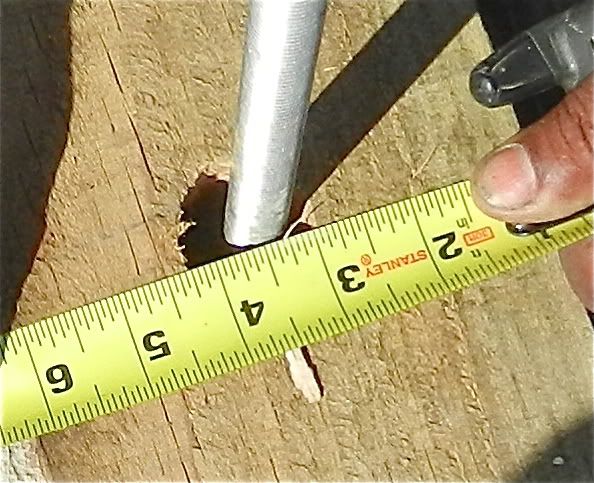

What looks like a row of flat blocks between the floor joists is actually the top of a 4"x6" block. These were installed at every mud sill. I couldn't see any anchor bolts. So I had them remove a few blocks and found that they bored an 1 3/8" diameter hole for a 5/8" anchor bolt. There are close to 100. All of the sill is 3X.
I found out today that there are closer to 200. Their engineer suggested running nuts to the concrete and stacking them to the height of the 3" sill to fill the void. This was after he came to the site and saw what I saw. I thought that was nuts. Then their engineer suggested a rectangular plate with 4 SDS screws. It is a Simpson product for this purpose. It looks like it might work but the braced walls have some large loads. I think their engineer is brand new out of the box. I told them to see our engineer.
The Simpson BPS with 4 screws will counter lateral loads when the holes are overbored.
However, it is up to the engineer to determine what the required shear capacity is and what the 4 screws will provide.

The epoxy is already available. It is used to repair split beams and such. The BPS is good for 1000#. I would have preferred the epoxy but their engineer chose the BPS. The epoxy would have been a faster fix considering the 4"x6" blocks that will have to be reworked but like I said earlier, the engineer is new at this and may not know about the epoxy. {That's a stupid remark because I am old at this and I didn't know about the epoxy either.}
