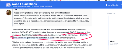

No drainage tile or pipe with a PWF (Preserved Wood Foundation) ⁉️

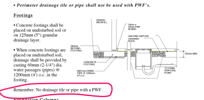

BC code requires foundation drainage "unless it can be shown to be unnecessary" ....
And there are 2 ways to achieve this- drainage pipes, or a granular layer.
For discussion: our office generally exempts drainage for situations where the space on both sides of a frost wall is infilled.
a "drainage system" is required
IAM just wondering why not to use a Drainage Pipe (Weeping TILE)
i can't for the "life of me" see why ❗❓
there may places where it specifically says NOT TO USE A DRAINAGE "PIPE" : /

Perimeter drainage tile or pipe shall not be used with PWF2.pngPerimeter drainage tile or pipe shall not be used with PWF.png
