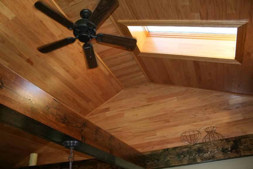

After the fact, we found this that once had a ceiling:
How does your department handle this?

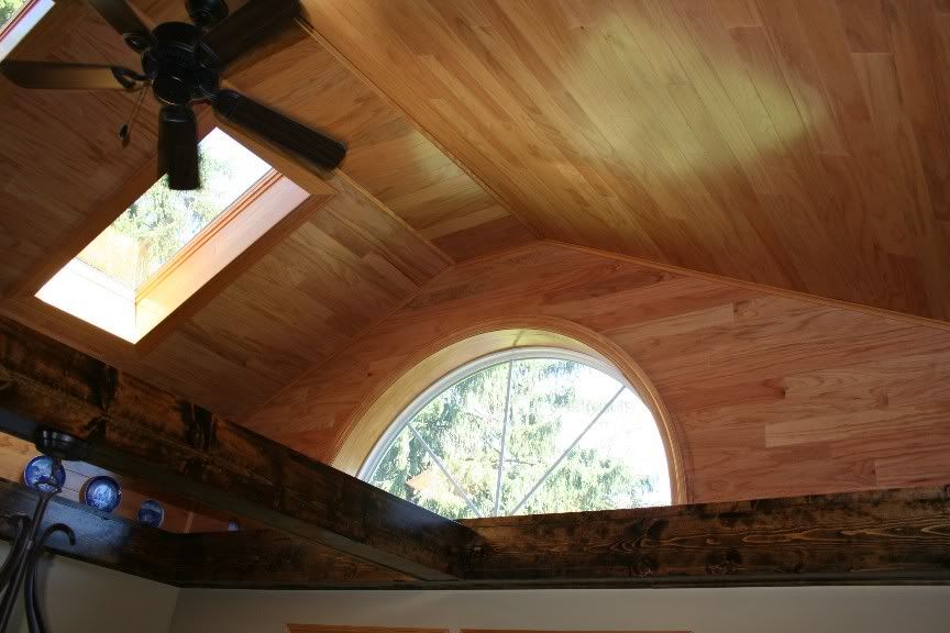

If that is a "Ridge Beam" buried where we can't see it. I want to know how they headered it over that window. Chances are that is NOT a ridge beam but only a ridge board. Skylights were not there either.
I'm sure you are right on all counts, I doubt theres a beam, or the header above the window.......get an engineer folks! That would be my comment.

Require that a testing laboratory or an engineer investigate and document the existing framing of the roof. Require pictures and other documentation be provided. Then require that the engineer provide calcuations or other evidence of code compliance.
Tell the owner that you consider the building to be not in compliance with the code and that you will take steps to abate the non-compliance but because you are a good guy you will give them a couple of weeks to resolve the problem.

We would allow them to expose the framing for an inspection, or have a licensed structural engineer sign off on the work. If the property owner chooses to do neither we 1.) Put the property owner in violation (which our jurisdiction does not pursue) 2.) Place a memo in the property file and 3.) Place a hold on all future building permits. I also remind them (as uncle bob stated) that insurance companies look for reasons to get out of paying claims, and unpermitted construction is a great reason.

Besides the structural issues, I wonder how long it will be before the roof rots out, assuming they have the insulation packed against the roof sheathing.

Pull back some of that purty finish to expose framing in suspect areas. If beyond the scope of the IRC, call an engineer. Double the amount typically charged for permit fees.
I sure would like to see the framing around that paladium window. Most likely the skylights are not framed correctly either. Did they claim ignorance of the requirement for a permit for this kind of work?
