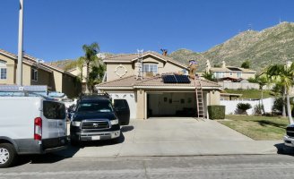

I worked a day in a city. The inspection was for a service panel upgrade and solar. There were a few corrections on the panel..One of which was "The water main shall serve as a grounding electrode with the connection within five feet of where it enters the building. The contractor was acting like I was being unreasonable....asking for my business card so that he could know whom he was complaining about. And just not happy.
Then he asked me when I would release Edison to energize the panel. I told him that after he does the corrections, the city will send an inspector and after it passes inspection, Edison will be notified. He replied with, "So you're going to leave the customer with no power?"
I told him to "figure it out."

I should have clarified that this is residential.
The picture of the front of the garage … i assume there are more panels on the side we can’t see.
