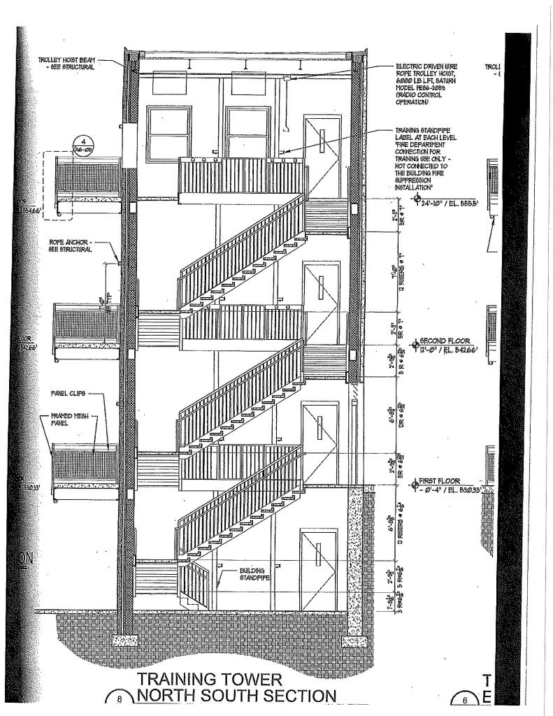

I apologize everyone, as usual I don't seem to give enough information in my OP's. The stair connects 3 floors; the basement garage; the 1st floor main level, the 2nd floor and the roof at the third floor. Except for the roof or 3rd floor level; all the other doors open into the stairway like it would normally require. The plans show no fire-resistance of this training tower. We are having this same discussion in the office; would it be correct to only require the garage level to be rated? Though it is not a means of egress the shaft connects three floors.
The "Training Tower" is shown in the lower left corner.
Thanks again.
Hmmmmmm . . . Seeing the drawing, I'm not sure if you can call it a shaft. Since it is outside the footprint of the main building, it doesn't seem to meet the definition. It does not connect vertical openings in successive floors since the floors appear to continue all the way to the wall.
It does not meet the definition of an exit enclosure, either.
I'm not sure there is justification to require a fire-resistive rating. Looks like a nice facility!
