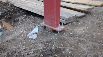

I really thought that proper installation of non-shrink grout under a metal column base was a Special Inspection item from chapter 17, but I don't see it in there. Wondering how others handle the inspection of this particular item? For fun, here's a pic of the current condition on site:
I have not seen one with a stack of shims or such small diameter anchors. The usual is not standing off that much and it gets grouted without special inspection.

Should be detailed in the structural plans or building supplier plans, with anchor size and strength requirement. They are generally grouted with ??,000 psi non-shrink grout tapered out at least 2". from the pic looks like those are not the approved A??? structural anchors either. If you send pics to the structural Eng. I'm sure he'd freak out. :eek:
Never seen shims either, and most of the time the columns need to be grouted before they are loaded with the the floor or roof assembly.

I used to see these often but not now. The stack of shims looks out of place and I can't tell from the picture, but I suspect that there are no jamb nuts. The anchors look small and the washers look smaller yet.
The arrangement in the picture just looks weak. With no leveling nuts it would be difficult to plumb the column.
