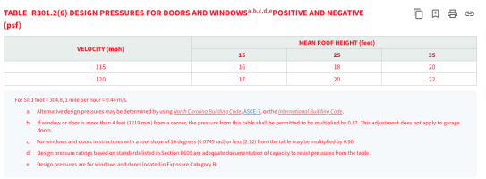

North Carolina Wind Pressures Chart for Residential Windows and Doors
13,302
These pressures are setting a low bar, but are only for a maximum mean roof height of 35' and a 120mph wind zone. So this will not apply to the coast.
